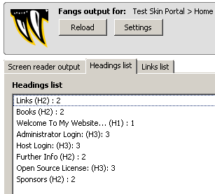

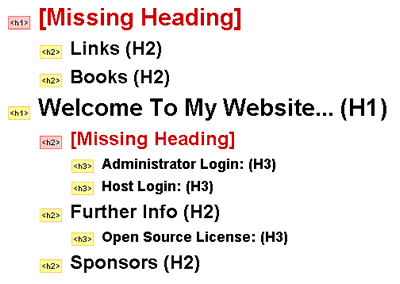

Helpful Tools
If you wish to analyse the document structure and header tags of a website page, the following tools are useful:
Firefox Web Developers Toolbar:
http://chrispederick.com/work/webdeveloper/
Using the Firefox web developers toolbar, go to Information / View Document Outline.
Fangs for Firefox: The Screen Reader Emulator
http://www.standards-schmandards.com/index.php?show/fangs
Fangs creates a textual representation of a web page similar to how the page would be read by a modern screen reader. The extension and source can be downloaded from the SourceForge project page:
http://sourceforge.net/projects/fangs

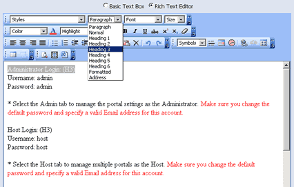

Once you have installed Fangs to your Firefox browser, right click on the page and select “View Fangs”. You will now be able to view your page as if viewed by a screen reader. You can also view the list of headers from the tabs at the top of the page.
Test the Tools
You can view examples of these tools in action by viewing the Document Outline / Fangs outline for these links:
http://www.skinningtoolkit.com/tabid/90/Default.aspx
http://www.skinningtoolkit.com/tabid/112/Default.aspx
If you view the majority of DotNetNuke websites you will notice that they do not make use of heading tags. View www.dotnetnuke.com in Fangs and the Web Developers Toolbar for an example.

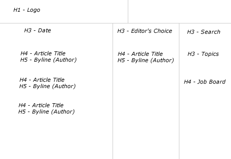

A List Apart - Home Page:
http://www.alistapart.com/
(fig. 1)
H1 tag surrounds logo of the site
<h1 id="masthead">
<a href="/"><img src="/pix/alalogo.gif" alt="A LIST Apart: For People Who Make Websites" /></a>
</h1>
Left column (Main Content)
H3 – Presents today’s date (top of main content column)
H4 - Article title - recent articles list, H4 and H5 repeated for each article
H5 – By-line (Article author)
Middle column
H3 – Editor’s Choice (Heading for this column of articles)
H4 – Article title
H5 - By-line, Article author
Right column
H3 – Search
H3 – Topics
H4 – Job Board
There are no H2 tags used in the Home Page. This is the only website from the selection that we have analysed that makes use of the H5 tag.

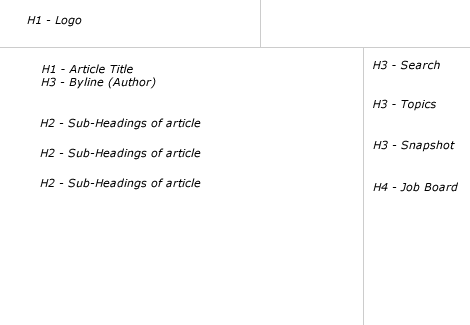

A List Apart - Article Page:
http://www.alistapart.com/articles/worldgrowssmall
(fig. 2)
Left column (Main content area)
No header tag around the date
H1 – The Article Title
H3 – By-line (Article author)
H2 – Sub heading of article
H2 – Further sub headings
H3 – Sub-sub headings of article
H2 – Learn More
H2 – Discuss
H2 – About the author
Right Column
H3 – Search
H3 – Topics
H3 - Snapshot
H4 – Job Board
H1 tag is used here for the main title, which is ideal for the search engines as they add further emphasis to any text within H1 tags. H2 and H3 tags are used as sub headings within an article. H3 is used for the title of each container within the right column.

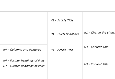

ESPN - Home Page:
http://www.espn.com
(fig. 3)
Right column
H1 – Chat in the Show! (latest chat shows)
H3 – next content header section in right column
H3 – Further heading sections of links in the right column
Left column
H4 – Columns and Features (bottom left column)
H4 – Further heading sections of links in the bottom left column
H4 – More links
Middle column
H2 – Top Middle column item title
H1 – ESPN News Headlines
H4 – Article title
ESPN have used the H1 tag twice. In this case they have used it for the latest headlines and chat shows. It appears as though they are using the Header tags to state the importance of each link section, but the location on the page of these header tags does not seem to match their importance.
For instance, why isn’t there a H1 tag, or any header tags in the top left section which is known to be the area that your eye goes to first on the web page? – Based on location importance of a page, you would expect the content in the top left of the page to have the highest priority, yet none of the content uses a header tag.
ESPN have used header tags from H1 to H4 within their home page.

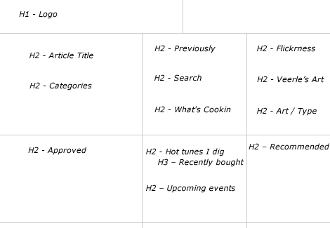

Veerle - Home Page:
http://veerle.duoh.com/index.php
(fig. 4)
H1 – Main title of website (graphic header of site)
<div id="header"><h1>Veerle's blog</h1></div>
Left Column
H2 – Latest post title
H2 – Archive by Category
Middle Column
H2 – Previously
H2 – Search
H2 – What’s Cookin here
Right Column
H2 – Flickrness
H2 – Veerle’s Art
H2 – Art / Type elsewhere
Bottom footer
H2 – Approved
H2 – Hot tunes I dig
H3 – Recently bought at iTMS (sub heading of Hot Tunes)
H2 – Recommended
H2 – Upcoming events
On the home page, the H1 tag is used for the website name and H2 tags are used for headings of each container section.

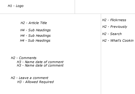

Veerle - Article Page:
(fig. 5)
Left column (main content area)
H2 – Article Title
H4 – Sub Heading of article
H4 - Further Sub Headings of article
H2 – Served So Far (Comments section)
H3 – Name date and time of each comment
H2 – Leave a comment
H3 – Allowed required (sub heading of leave a comment)
Right Column
H2 – Flickrness
H2 – Previously
H2 – Search
On an article page:
H1 used for title of website
H2 used for article title and for headings of different content sections
H3 used as sub headings for left column under H2 comment sections
H4 used as sub headings for articles

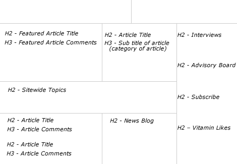

Think Vitamin - Home Page:
http://www.thinkvitamin.com
(fig. 6)
No H1 Tag used
Top left
H2 – Featured article title
H3 – Featured article comments
Top middle
H2 – Article title
H3 – Sub title of article (category of article)
Middle section
H2 – Sitewide topics (listing of categories)
Bottom left column
H2 – Article Title
H3 – Article comments
H2 – Article Title
H3 – Article comments etc.
Bottom middle column
H2 – News Blog
Right Column
H2 – Vitamin Interviews
H2 – Advisory Board
H2 – Search etc.
For the Vitamin home page:
H1 – not used
H2 used as article titles for container sections of home page
H3 used as comments link for articles and sub-title (category of an article)

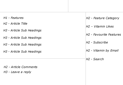

Think Vitamin - Article Page:
http://www.thinkvitamin.com/features/css/stop-css-hacking
(fig. 7)
Left Column
H1 – Features
H2 – Article Title
H3 – Sub Headings in the article
H2 – Comments section
H3 – Leave a Reply
Right Column
H2 – Feature categories
H2 – Vitamin Likes
H2 – Favourite Features
H2 – Subscribe
H2 – Vitamin by Email
H2 – Search
For article pages within the Vitamin website:
H1 used to display category of article ie. Features
H2 used for article titles and as titles for different content area sections
H3 sub Headings in an article

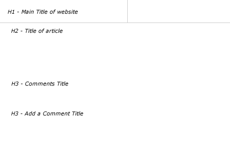

Web Standards - Home Page:
http://www.webstandards.org
(fig 8.)
H1 - Main title of website (graphic header of site)
Right Column
H2 – Title for right column (eg. Task Forces' Latest)
H3 – Category of article (eg. Accessibility TF)
H4 – Article title
(H3 and H4 repeated for each category and article)
Left Column
H2 – Title for left column (eg. Recent Buzz)
H3 – Recent article title
H5 – Sub Headings for article
H3 – More buzz articles
Web Standards - Article page:
(fig. 9)
H2 – Title of article
H3 – Comments title
H3 – Add a comment title

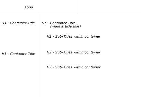

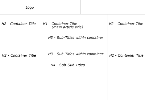

DotNetNuke - Header Tags Suggestions and conclusions

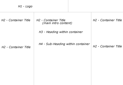

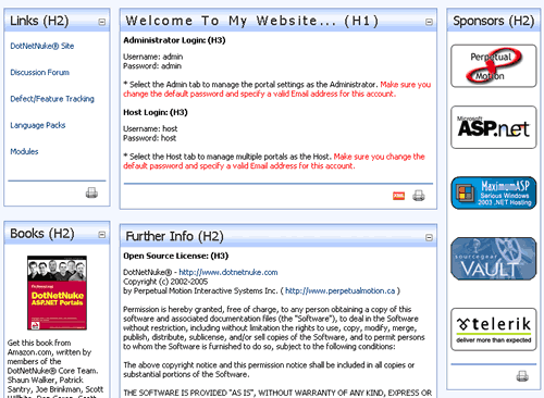

Here I am going to offer some suggestions for how you could approach using header tags within your DotNetNuke skins based on the approaches taken in the websites we have analyzed.
Please bear in mind that there is no definite answer for the use of header tags, it all depends on the layout and content within your own website.
From analyzing the various websites we can see that there is not a standard implementation for the use of header tags. We can see however that they have used the header tags to define a ‘level of importance’ for the various elements on the page and that the header tags are not necessarily listed in tag number order, ie. h1, h2, h3, h4, h5, h6.
We are going to discuss and use this ‘level of importance’ method within our DotNetNuke skins.
Considerations
H1 tag
Ideally we only want to place one H1 tag on the page. This is so that the search engines can read and understand exactly the topic for the page.
Approaches taken:
From the websites we have analysed we can take two approaches:
1) H1 tag replaced by the logo
Place a H1 tag which contains the main title of the website. This text is replaced by the logo of the website for users with standard browsers, while search engines and screen readers will read the H1 text.

Structure One
The first structure that you can see in figure 10 is based on the Home Page of a website using the DNN-Blue skin layout.
The H1 tag is placed around the logo
H2 tags are placed in the title of each container
H3 tags are used as headings within a container
H4 tags are used as sub-headings within a container
DNN-Blue Home Page:
(fig. 10)
Structure Two
The second structure in figure 11 is based on an Article Page of a website using the DNN-Blue skin.
The logo does not use any header tags
The H1 tag is placed in the title of the container that holds the article
H2 tags are used as sub-headings within the article
H3 tags are placed in the title of any further containers on the page (for example holding an image or links module)
DNN-Blue Article Page:
(fig. 11)

Structure Three (combined)
The H1 tag is placed in the title of the container that holds the article (As discussed earlier, this ensure that every page has a different H1 title, which will improve the search engine results)
H2 tags are placed in the title of any further containers on the page (for example holding an image or links module)
H3 tags are used as sub-headings within the article
H4 tags are used as sub-sub headings within the article
This is a similar structure as used by an article page on http://veerle.duoh.com/index.php
DNN-Blue combined layouts for one skin:
(fig. 12)

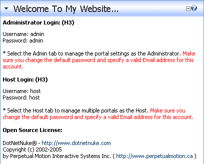

You will see in figure 14 that the header image area still has a height larger than the original. This is caused by the h2 tag. All header tags automatically by default add margins to the top and bottom of the text. We therefore need to remove all of the margins for the h2 tag.
- Open the skin.css file for the DNN-Blue skin
- Add the following code:
h2
margin: 0;
padding-left: 3px;
Here you can see we have removed all margins from the h2 tag and we have also added 3px of padding to the left of the h2 tag. This is to replace the “ ” that we removed from the skin.ascx file.
The container with margins removed and padding applied (fig. 15)
![h2 added with spacing fixed](/Portals/0/tutorials/skins/header_tags/h2_added_spacingprob_fixed_sm.gif)
We have now completed a container which places h2 tags around the title of the container.

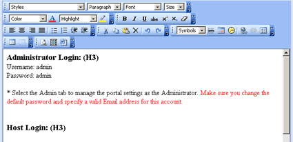

To format the text within the Text / HTML module
- Click on Edit text
- Remove the current default styling that is used for the titles, ie:
- Click on HTML
- Remove any bold tags ie. <b> or <strong> from the titles, ie:
<b>Open Source License:</b>
- Add the h3 tag to the titles, ie:
- Click on Design
- Highlight the text for the title
- Go to the ‘Paragraph’ drop down list
- Select ‘Heading 3’
- Click on update
(View example images below)
Formatting a title to use h3 tags (fig. 17)
![Selecting h3](/Portals/0/tutorials/skins/header_tags/h3_selecting_sm.gif)
H3 tag placed around titles (fig. 18)
![H3 tag placed around titles](/Portals/0/tutorials/skins/header_tags/h3_selected_sm.gif)
This creates the view you can see in figure 16.

Demo of Fangs
If we now view the Home page using:

Fangs Headings List
You will see that Fangs can read and display the list of header titles within our Home page.
Demo of Document Outline
You will see that the document outline view states that there are missing headings. This is because we have used the heading tags to outline the importance of the content, rather than placed the heading tags in the order of h1, h2, h3, h4, h5, h6 on the page.
If you view the websites that we analysed at the beginning of the tutorial, you will also see that some of them also receive missing heading statements.
Missing heading statements can be prevented when you design your actual skin. A missing heading statement is caused because the document outline is created by the order of the source code.
In the DNN-Blue skin, the order of the source code consists of the left pane, content pane and right pane.
This means that the first header tag that is read is a h2 tag, rather than a h1 tag and therefore the reader displays a missing header statement.
This doesn’t cause any error problems, but it is something to be aware of as the most important element for your skin design is to have the important content (which should contain a h1 tag) appear at the top of the source code.
