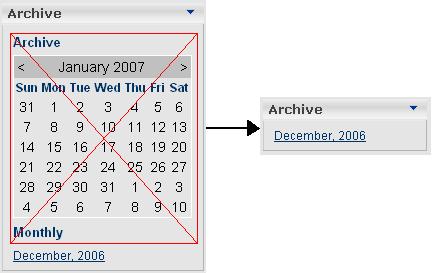

Step 1: removing needless parts
Some information displayed in a module may be redundant and would be better hidden. For example, the calendar in a blog archive view is needless if posts aren’t made often. We will now demonstrate how to remove the calendar from the Blog archive.
removing needleless parts
Take a look at the contents of Archive.ascx file (under DesktopModules\Blog folder). It describes how the archive view looks. Several lines in the beginning of the file contain definitions for unwanted items:
    <tr>
        <td>
            <asp:label id="lblArchive" …>Archive</asp:label>
        </td>
    </tr>
    <tr>
        <td>
            <asp:calendar id="calMonth" …></asp:calendar>
        </td>
    </tr>
    <tr>
        <td>
            <asp:label id="lblMonthly" …>Monthly</asp:label>
        </td>
    </tr>
However we cannot simply remove label and calendar controls since they are referred to in the underlying dll’s. Instead we should attribute them as invisible:
    <asp:label visible="false" …>Archive</asp:label>
    <asp:calendar visible="false" …></asp:calendar>
    <asp:label visible="false" …>Monthly</asp:label>
This will make a module contain only what is desired and nothing more.

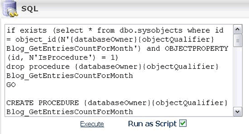

In order to get the number of posts made in a particular month a SQL query should be executed. Since inline querying is forbidden in DotNetNuke we need to create an appropriate stored procedure which will return the desired number.
A stored procedure can be created by means of the DotNetNuke SQL tool. Open it by logging in as the Host user and going to the Host > SQL menu item. Then paste there the stored procedure creation query, select “Run as Script” and click “Execute”.
a stored procedure
(The stored procedure code can be downloaded with the source code at the bottom of this page.)
