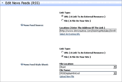

Step Two - Uploading the XSL transformation file
Once you have created your XSL file, you need to upload it to your DotNetNuke portal.
In the module settings of the RSS News Feed Module, select Edit News Feed:
  1. Under News Feed Style Sheet, select “Link Type: File (A File On Your Site)”
  2. Click on Upload New File
  3. Upload the new XSL file
  4. Click on Update
Edit News Feeds (RSS) Module
Uploading an XSL News Feed Style Sheet
The RSS News Feed Module should now display the RSS Feed with the correct HTML formatting.
