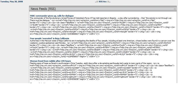

I think I have some sense....
When I add one external RSS feed site in News Feed Module for testing I can only see the code like attached not right contents like below.
(when I copy and paste here I can see the all contents even but not my site as you can see the attached screen shot.)
FARC commander gives up, calls for dialogue
The commander of the Revolutionary Armed Forces of Colombia's Force 47 has told reporters in Bogota -- a day after surrendering -- that "the solution is not through war. There must be dialogue."
Four people 'executed' in Baja California
Authorities in the Mexican state of Baja California are investigating the deaths of four people, including at least one American, whose bodies were found in a canyon over the weekend, a police spokesman said Monday.
I think you know what it is....^_^
Please let me know how I can fix this and thank you in advance.
Posts:2881
23 May 2008 7:37 AM
That is covered in this tutorial:
You may also want to look at:
