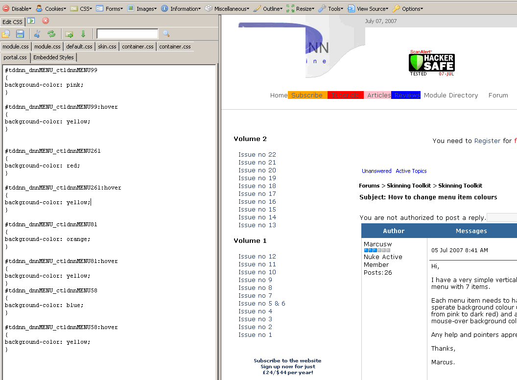

Posts:3308
07 Jul 2007 4:01 AM
yes it is, here's an example image that I applied to this live site - each menu item has a different background image:
http://www.dnncreative.com/Portals/0/pics/forum/forum_menu_mulitcolours.gif
you can see the code for it on the left hand side.
Like I said, you have to use the Web Developers Toolbar to find and target the id of each table cell
