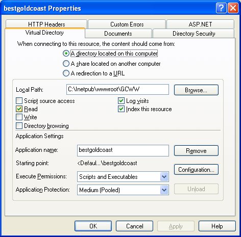

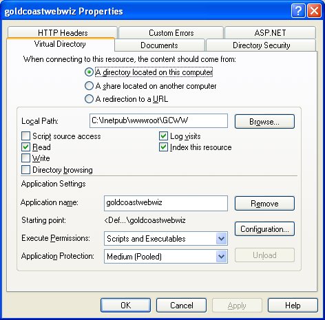

Hi Guys
Just successfully installed DNN 484 as a fresh installation on localhost.
Logged in and tested that all are working.
I previously backed up a live web site, and have 2 portal aliases that I would like to test locally.
Properties of the IIS installation is attached.
Can someone please let me know if this is possible, and some ideas of how to succeed.
Thanks!!!
Posts:3325
13 Aug 2008 7:53 AM
In ISS, create a virtual directory for each portal, they should be pointing to the same dnn installation files - make a note of the URL for each portal
Then add those portal aliases to the appropriate portal.
- You may need to do this directly in the tables, look at the portalalias table.
