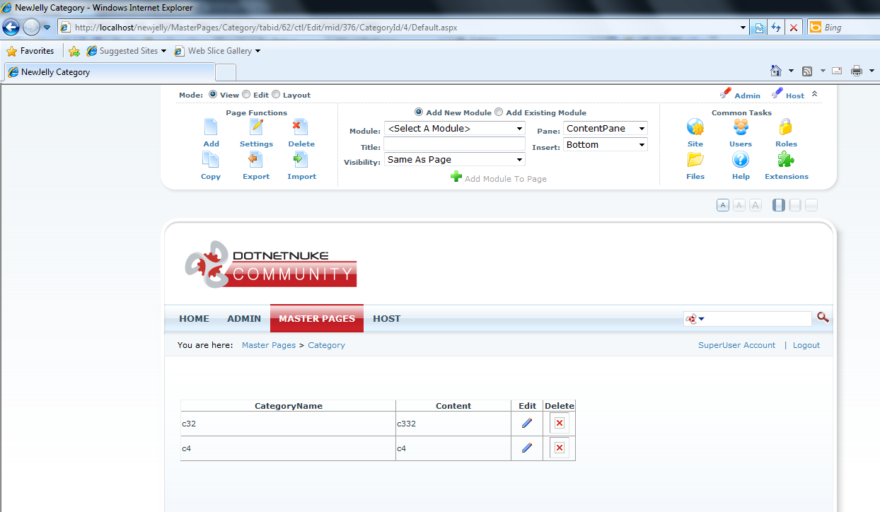

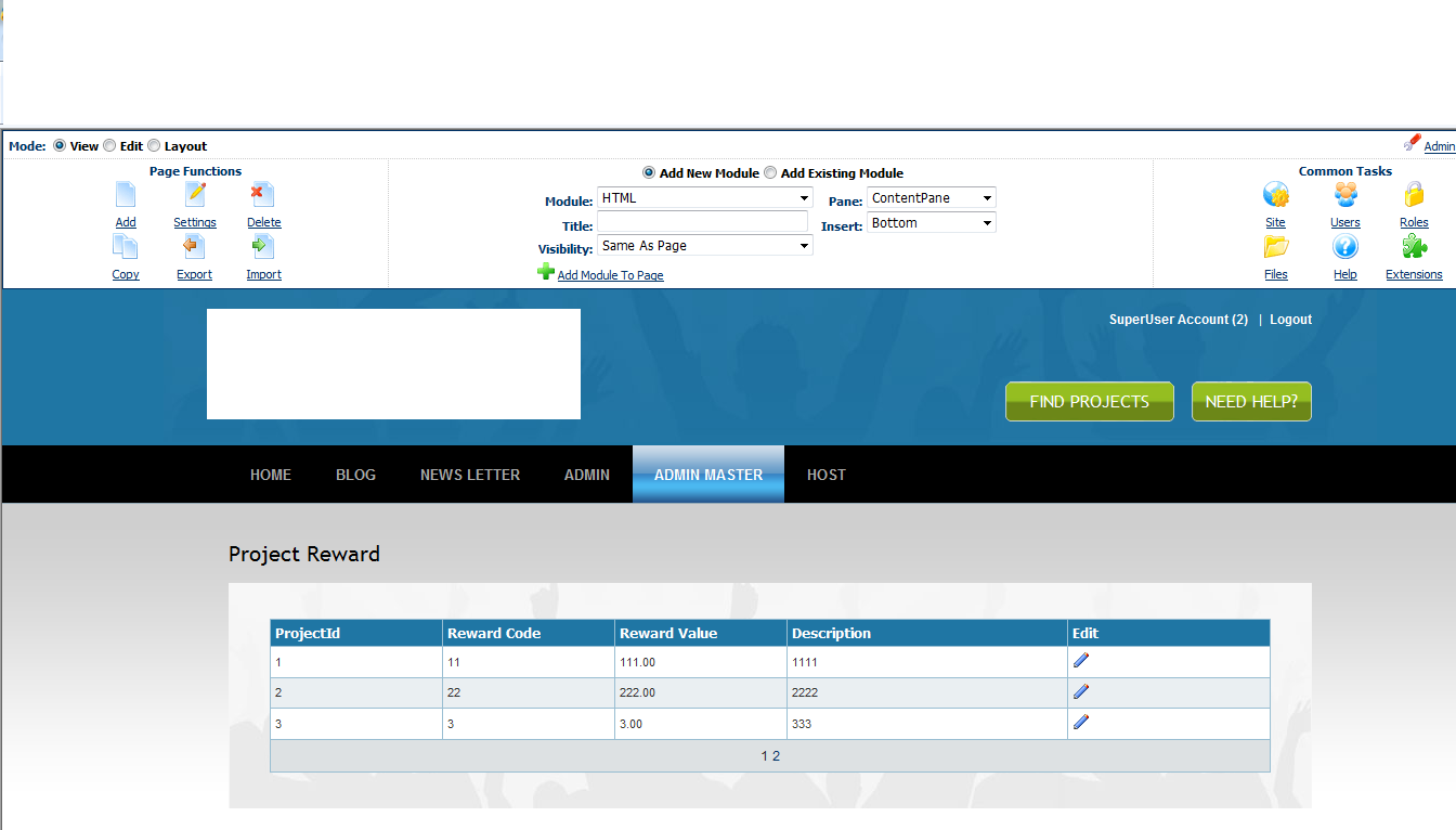

    Hello abhi, Let me ask you one more query may be you can help me.I am a begineer in DNN. I have custom module having category master in our project. Its a very simple logically just insert, update and delete. There is a grid in this page having edit button. Now when i login as host and if i select view mode and click on edit button it is not redirect to edit page. and if i select edit mode from top and do the above things it is working fine. Now when i give to my client he is only view the page and edit the category table , i don't wont to give changes of layout to my client or normal user for this page. Any solution if possible plz. Is there any solution to hide control panel for just normal user. I am using DNN 5.3. i attach page layout may be for more helpful for you to guide me. Thanks in advance, Amit.

    hi abhishek, still waiting for you response. in follwoing image you can see page index ( a very simple thing) is only working if i select Edit mode from top if i select View Mode from control panal. it is not working . Plz help if you have any idea.

    To hide the control panel u need give rights to your module. Control panel will be visible only for admin and host user.
    You can do so by open the page inside which your module reside then click settings and then give rights to the appropreate users.
    And to have edit module, u can do so by edit your module definition then add definition if not already added then add user control(can be type edit,setting).
    Hope that helps you.
