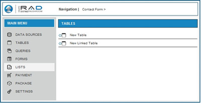

So first we will access the DNM Rad Control Panel, as you can see the fifth option is ‘Lists’, click on Lists to access the lists screen.

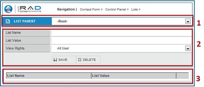

The lists screen consits of three sections, the list parent (1), list information (2) and list preview (3).
The DNM Rad List Screen
1. List Parent – This is where you can setup the parent list, this means that a list can have many child lists. It is also built like this so you can identify the list you are going to use without limiting the user to have only one level per list.
So for example you can have the following List:
  • Clothes
    • Trousers
    • Shirts
      • Long Sleeved
      • Short Sleeved
2. List Information – This section is where you define your list item (which can be used as a list parent as well). So to use the same list example, first we need to input the parent list ‘Clothes’. So we make sure that from List Parent we select ‘-Root-‘, and then type the list name (Clothes) and the list value (Clothes), view Rights can be left ‘All Users’. Click Save to save the list, which now can be used as a parent for Trousers and Shirts by selecting it the List Parent dropdown.
View Rights can be used to limit a list entry so for example ‘Short Sleeved’ to be available for a particular User Role only.
3. List Preview – This is where the list item under the selected List Parent is displayed.

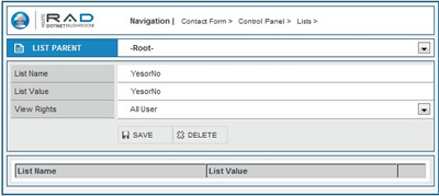

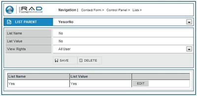

With the list screen explained we will go into creating the lists required for our contact form. We need to create a parent list which we will name ‘YesorNo’, the screenshot below gives you exactly how this should be created.
Parent list named YesorNo

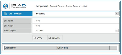

Now we need to create the list items for the list ‘YesorNo’, we do this by selecting ‘YesorNo’ from the list parent dropdown. Then add the two list items Yes and No, note that the list value is what will be saved if you save the information gathered from the form. Even if you send the information via email the list value will be sent in the email, so make sure to use a list value that fits the purpose of the form.
Since this is a contact form we will use a readable list value. Follow the screenshots below to add the two list items.
Add the 'Yes' list item
Add the 'No' item

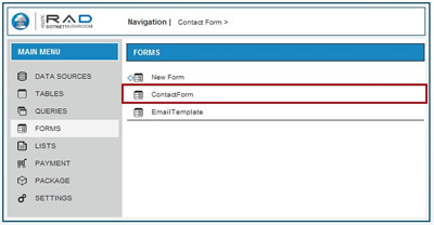

We have successfully created our list, now we need to deploy the control in our contact form to use the list we just created. Go back to the control panel and click on Forms; click on ‘ContactForm’ to access the contact form template.
Click on 'ContactForm'

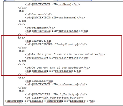

Go into templates and in the Body Template add the following code.
Add the following code to the Body Template
We will use a dropdown to list the countries and two radio button lists to display our ‘YesorNo’ pre-defined list. Now click on properties to set up our new controls to work as planned.

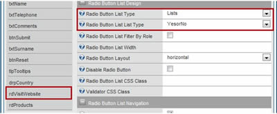

Next we need to set the properties of the second control called ‘rdVisitWebsite’. Click on the control to load the control properties.
Here we need to modify two properties, first we need to modify the List Type and set this to ‘Lists’ then we need to select the list we want to load. We shall be using the list ‘YesorNo’ as shown in the screenshot below. Do the same for the control ‘rdProducts’.
Set the properties of the 'rdVisitWebsite' control

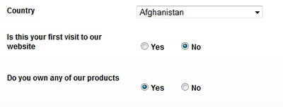

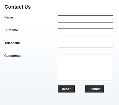

After saving, view the contact form and as you can see in the screenshot below, we have our new control populated from lists.
View the Contact Form
As you can see the process of binding these controls to these lists was very easy and efficient. Lists give you the possibility to set a pre-defined list that can be used in more than one place, without going through the effort of setting up a table and filling the table with data.

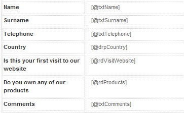

The last thing that you need to do to complete this application is to add these three new controls to the email template (Form Name: EmailTemplate) so that the data selected in the contact form will be sent via email. Use the screenshot below as a reference on how you can achieve this.
Add new controls to an email template
