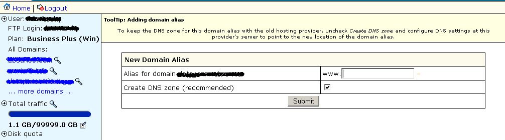

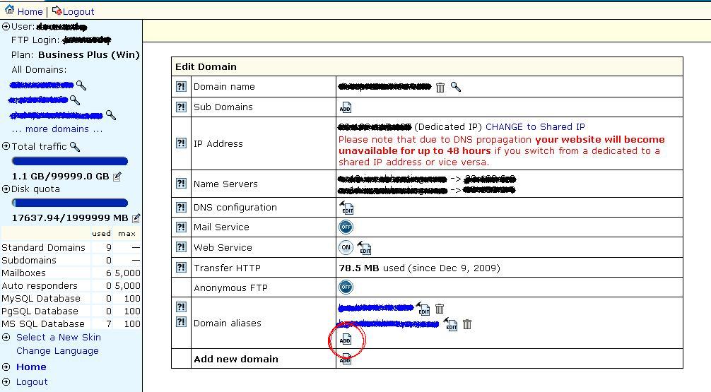

My hosting company uses HSphere control panel and all you do is:
-Click on the top level domain name and click on the ADD icon for Domain Aliases
-Then you only need to type "domainname.com" and check the box for DNS. HSphere automatically adds "*.domainname.com" to the A Record so "www.domainname.com" will work too. You can even add mail services for each of the parent portals!
All of the other steps in Issue 17 are the same.
Hope this helps everyone with this style control panel!
