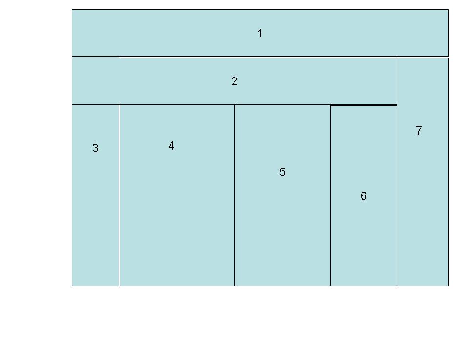

I am building a sport website and I want to buy a skin that has or have the possibility to offer me this structure. Please Look at my attachted file and give me some feedback.
Is it possible? is their any shortcuts?
1. Banner pane
2. Top pane (image + company logo)
3. Vertical menu
4. Articles/news
5. Minor Article and news(older news)
6. Latest news (last 12h)
7. Advertising
Is it possible for me to buy a skin that has 7 or 8 panes and then organize them after my liking?
Any feedback? Does such skins exist or is it better to build one?
regards
Alexander
derpir
Nuke Ace
Nuke Ace
Posts:43
16 Nov 2008 3:43 PM
sorry the picture got  bigger than I thought
Posts:2535
16 Nov 2008 4:13 PM
Yes, it's "possible" to buy such a skin, but you might want to consider getting a custom or semi-custom skin that meets your requirements exactly. I don't know a skin that fits this design off the top of my head, so I'd suggest that you look around -- check Snowcovered.

I think I´ll buy a skin with 5-7 panes and then organize 'em my way. Do you have any good suggestions or links to where I could find semi-custom services?
thanks!
//Alexander
Posts:3442
17 Nov 2008 9:43 AM
You may want to look at these tutorials, it's pretty straight forward to re-organise panes:
These are the intro to skinning tutorials, if you want more, there are loads on the main tutorials page.
