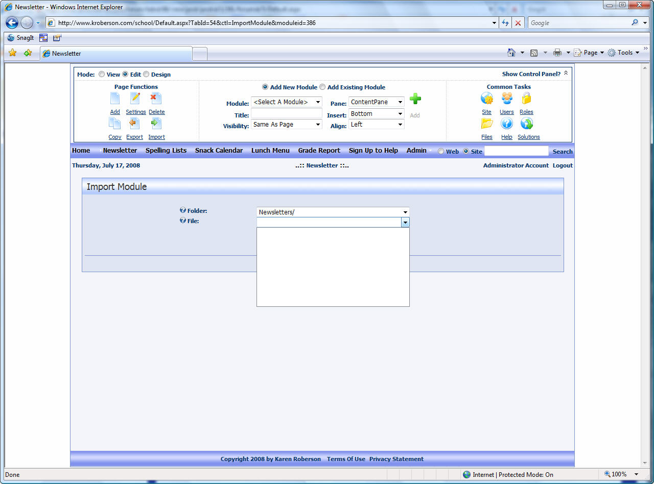

I'm sure I'm just missing something, but when I try to import .jpg files into my standard dnn document module, the list is blank.  I have checked the folder and file permissions in File Manager and I have tried this under both the admin and host logins.

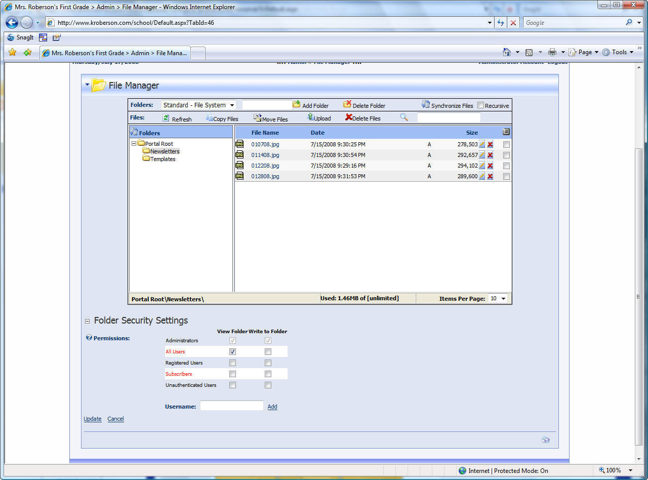

The file selection list you use when you attempt to import a file into the document module.
I've attached two screenshots.  The first is my file manager.  As you can see the Newsletter folder has five .jpg files in it and the folder permissions are set to View for All Users.  The second is the import selection where you can see it is blank.

There's nothing like a good screen shot or two to help the understanding.
You've added files via the File Manager, and now you want to make these available in the Documents Module. What you want to do is "Add a Document" using the Document Module's dropdown menu. Then you fill in the form to describe the document and you select the file using the two dropdown boxes labelled "Link." When you are done, click "Update" at the bottom. Note that you also have the option to upload new files right here, rather than in the File Manager.

Ah, okay that makes sense.  I told you somebody needed to help my pull my head out!
So, what is the "import content" for?
Kevin
Posts:2371
17 Jul 2008 9:48 PM
Export and Import are operations by which you can Export all of the content of a module into an XML file. That can then be used to Import the same data into an empty module of the same sort.
