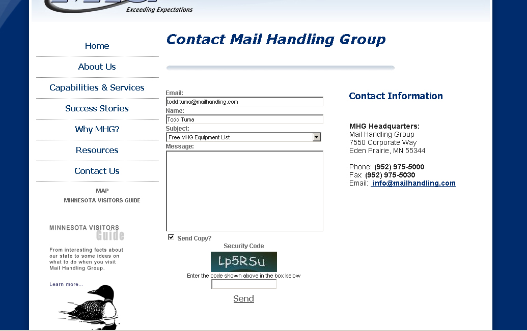

In my Feedback module>advanced settings
I entered the following which got ride to the question marks and alt text.  I am still trying to make space between the Name, Subject amd Message labels and the previous form fields.  I have been experimenting with the Name label pulling information form the code revieled in the Firefox WebDevelpers Toolbar. Note the follwing...... It does not make a difference.  I have enclosed a screen shot for your viewing.  Please advise.
Header
(NOTE: code is in the attachement)
Footer
In the screen shot image, you will note the Email Field and the Name field show a default entry.  I want to remove those.  Please tell me how to do this.  (They do not show up in IE, only in Firefox)
Marion
145401666671.txt
Joseph CraigUser is Online
Posts:9299
2010-04-05 01:52 PM
If you use something like the SubHead coding that I showed in an earlier message, you will be able to create some vertical spacing between the elements.
I believe that pre-filling some of the boxes is related to being logged in or not and should not depend on the browser.  Try logging out and see what you get.
