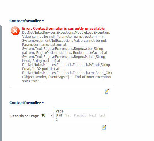

    Hi Lee,
    I've installed the Feedback Module on my local installation (DNN 5.1.4). I've added some categories and subjects and changed the settings. No problems so far.
    When I fill in the form and send it I get an error (see attachements).
    Can you help me with this?
    Thanks and kind regards,
    Jeannine
    Posts:9008
    2010-03-03 12:51 PM
    Check your installation's Event Log and post the more detailed error message that you'll find there.
    Also, is SMTP setup?  Have you successfully sent emails from the system?
    jesp18User is Offline
    Posts:23
    2010-03-03 01:07 PM
    Hi, I've checked my smtp settings and also did a test. Email was send succesfully.
    Event log.
    ModuleId
    : 436
    ModuleDefId: 110
    FriendlyName: Contactformulier
    ModuleControlSource: DesktopModules/Feedback/Feedback.ascx
    AssemblyVersion: 5.1.4
    PortalID: 0
    PortalName: K2 Infra - Consultants
    UserID: 1
    UserName: hostus01
    ActiveTabID: 63
    ActiveTabName: Organisatie
    RawURL: /k2infra/Organisatie.aspx
    AbsoluteURL: /K2Infra/Default.aspx
    AbsoluteURLReferrer: http://localhost/k2infra/Organisatie.aspx
    UserAgent: Mozilla/4.0 (compatible; MSIE 7.0; Windows NT 6.0; GTB6.4; SLCC1; .NET CLR 2.0.50727; Media Center PC 5.0; .NET CLR 3.5.21022; .NET CLR 3.5.30729; OfficeLiveConnector.1.3; OfficeLivePatch.0.0; .NET CLR 3.0.30729)
    DefaultDataProvider: DotNetNuke.Data.SqlDataProvider, DotNetNuke.SqlDataProvider
    ExceptionGUID: 70d7d233-e879-4d4b-8c06-5ed1f2fb816c
    InnerException: Value cannot be null. Parameter name: pattern
    FileName:
    FileLineNumber: 0
    FileColumnNumber: 0
    Method: System.Text.RegularExpressions.Regex..ctor
    StackTrace:
    Message: DotNetNuke.Services.Exceptions.ModuleLoadException: Value cannot be null. Parameter name: pattern ---> System.ArgumentNullException: Value cannot be null. Parameter name: pattern at System.Text.RegularExpressions.Regex..ctor(String pattern, RegexOptions options, Boolean useCache) at System.Text.RegularExpressions.Regex.Match(String input, String pattern) at DotNetNuke.Modules.Feedback.Feedback.IsEmail(String Email, Int32 portalid) at DotNetNuke.Modules.Feedback.Feedback.cmdSend_Click(Object sender, EventArgs e) --- End of inner exception stack trace ---
    Source:
    Server Name: PC_VAN_JEANNINE

    Posts:9008
    2010-03-03 01:15 PM
    Hmmm.
    You might want to try adjusting the modules settings to see if you can determine which parameter is causing the problem.  For example, turn off moderation and turn off categories.  If you have checked "Use category value as Send To" turn that off and make sure that there is a valid email address in the Send To setting.
    The problem appears to be related to an email address, so pay attention to the module settings related to email addresses.
    Posts:23
    2010-03-03 01:33 PM
    It's going wrong when I enable the setting: Use Category value as Send To. There is a valid email address in the value field (see attachment). It looks like the system is not picking up this value.
    When I disable this setting email is sent.
    Kind regards, Jeannine
    Posts:9008
    2010-03-03 01:45 PM
    I've never used this option before.  I believe that Lee does discuss category values in the current tutorial (I haven't actually had a chance to view it yet), so you might want to review that if you haven't already done so.
    But, at least we've located the source of the problem.
    Posts:23
    2010-03-03 02:19 PM
    Hi Joe,
    Lee does discuss the category values and yes, I've viewed them. I followed the tutorial, but I still got the error.
    It seems like the module is not picking up the list value for the category.
    Maybe Lee can have a look at it again. Maybe it's an DNN 5.1.4 issue?
    2010-03-03 02:40 PM
    I just tested this in 5.1.4 and get the same error, I would suggest upgrading to the latest version.
