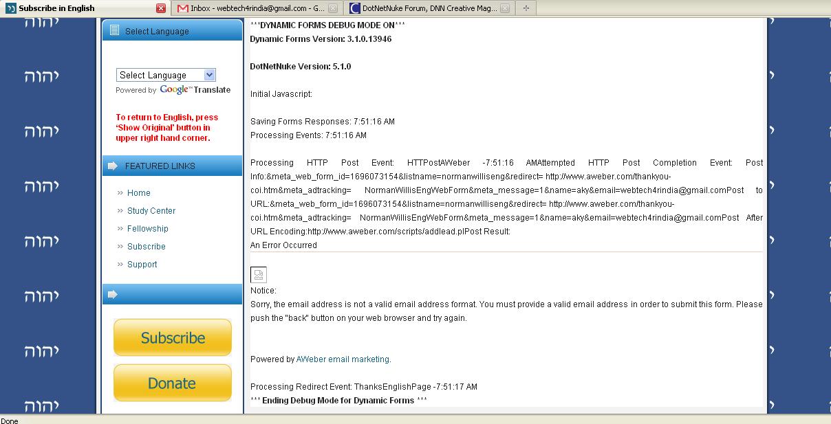

I ran out of time, and hired a developer. He is trying to add the Dynamic Form module in conjunction with Aweber as described in your video tutorials. After debugging the dynamic module, it tells him the email address is not a valid format:
Saving Forms Responses: 10:25:41 AM
Processing Events: 10:25:41 AM
Processing HTTP Post Event: HTTPostAWeber -10:25:41 AMAttempted HTTP Post Completion Event: Post Info:&meta_web_form_id=1696073154&listname= normanwilliseng&redirect= http://www.aweber.com/thankyou-coi.htm& meta_adtracking=NormanWillisEngWebForm& meta_message=1&name=testuser&from=webtech4rindia@gmail.comPost to URL:&meta_web_form_id=1696073154&listname= normanwilliseng&redirect= http://www.aweber.com/thankyou-coi.htm& meta_adtracking=NormanWillisEngWebForm& meta_message=1&name=testuser&from=webtech4rindia@gmail.comPost After URL Encoding:http://www.aweber.com/scripts/addlead.plPost Result:
An Error Occurred
Notice:
Sorry, the email address is not a valid email address format. You must provide a valid email address in order to submit this form. Please push the "back" button on your web browser and try again.
Powered by AWeber email marketing.
Processing Redirect Event: ThanksEnglishPage -10:25:42 AM
*** Ending Debug Mode for Dynamic Forms ***
My developer wants to know which email address Aweber is talking about, and what needs to be done to address the issue.
Norman

Yeah i did tried it with other email address as well and same error message i recieved. When i bind the Aweber code directly to HTML page and then try to submit. That time it showing on the Aweber newsection( it works). So problem seem to be the HTTP Post action section of Dynamic Part.
-Aky

HTTP Post URL: http://www.aweber.com/scripts/addlead.pl
HTTP Post: &meta_web_form_id=1696073154&listname=normanwilliseng&redirect= http://www.aweber.com/thankyou-coi....dtracking= NormanWillisEngWebForm& meta_message=1&name=$(Name)&from=$(Email)
Since the aweber code working fine when i enter aweber code in HTML page. So just issue with the post method of dynamic? Or something we missing with the settings.
Hope to have quick word with you.
-Aky

I just tested submitting a form to aweber as I noticed some of the parameters have changed and it still works ok.
&meta_web_form_id=1948359850&listname=dnncreative_tes&redirect=http://www.aweber.com/thankyou-coi.htm?m=text&meta_message=1&name=$(Name)&email=$(Email)
Looking at your HTTP code I think you may have spaces in your code, remove all spaces - it should be one continuous line of code
&meta_web_form_id=1696073154&listname=normanwilliseng&redirect= http://www.aweber.com/thankyou-coi.htm&meta_adtracking= NormanWillisEngWebForm& meta_message=1&name=$(Name)&from=$(Email)
for example I can see a space here after the &:
