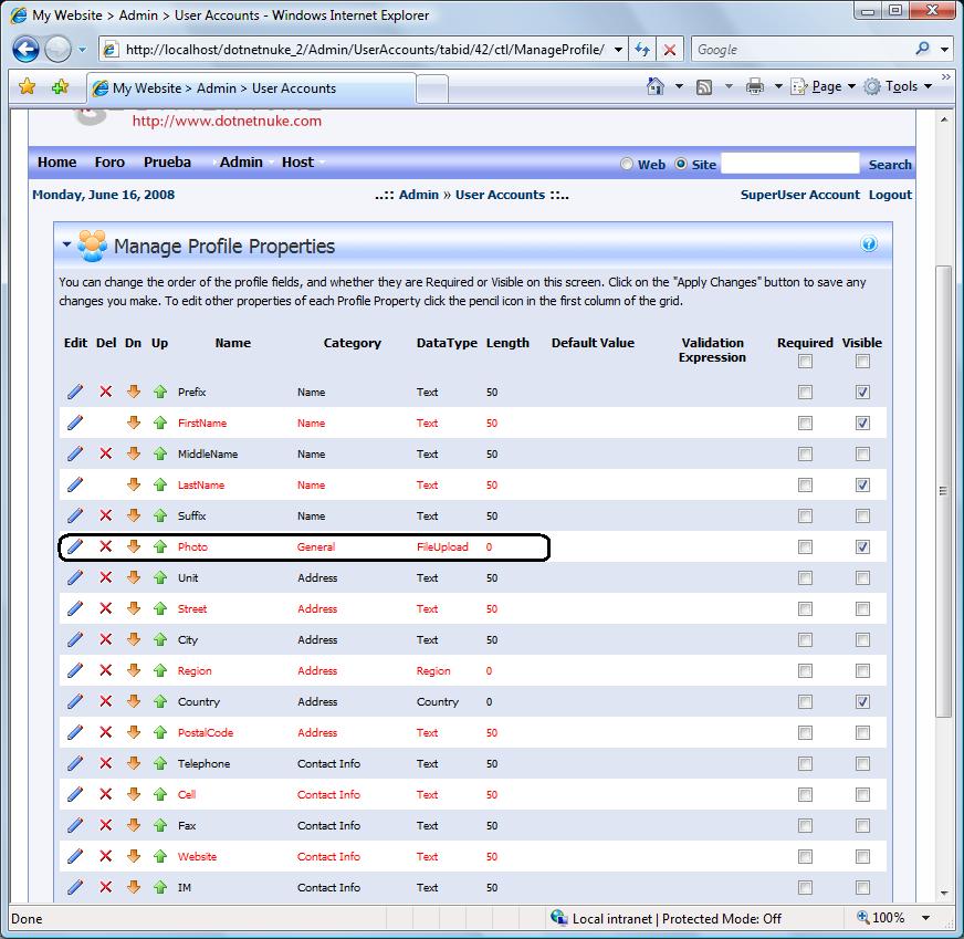

I was working on this all the day and finally I got it , here is the solution:
You must create a descendant class from EditControl supporting upload operation.
Because of user profile control is AJAX compatible, you have to create an alternative control to upload file to server. Standard FileUpload WebControl will not work.
In dnn database you have to create a row in table: "dnn_Lists" in order to create the new data type.
My solution was here:
http://www.nearsolutions.net/Servicios/Descargas.aspx
You can freely download FileUploadEditControl and GMailUpload webcontrol
GMailUpload webcontrol is for supporting upload over ajax enviroment.
Hope this work

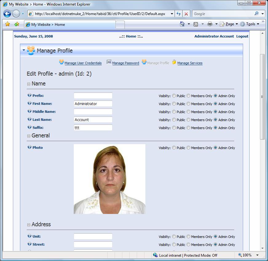

Could you explain how you setup the FileUploadEditControl.vb with GMailUpload.dll? I get the following "x" after setting up the control in the profile property editor. For some reason the control is only rendering in view mode. In your screen shots it only shows the rendering in view mode but not the edit mode. Could you post a screen shot of the control rendered in edit mode?
benito6000User is Offline
Posts:3
2008-07-28 08:11 AM
The control is rendering in edit mode, you have to click over the image in order to change it, but here is the issue that I forgot to explain in the post:
Is important to place the files "Upload.aspx.cs" and "Upload.aspx.cs" in the root directory of Dnn installation, These files can be found in folder TestWebApp in GmailUpload.ZIP
Good look.
